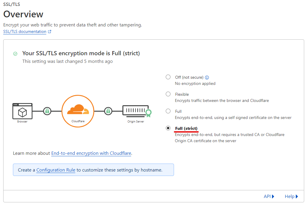

3. SSL/TLS mode in Cloudflare for the domain should be set to Full (Strict)

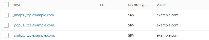

4c. Locate the SRV records for the domain
4d. Adjust the Value of each of the three SRV records from example.com to mail.example.com and save the changes
