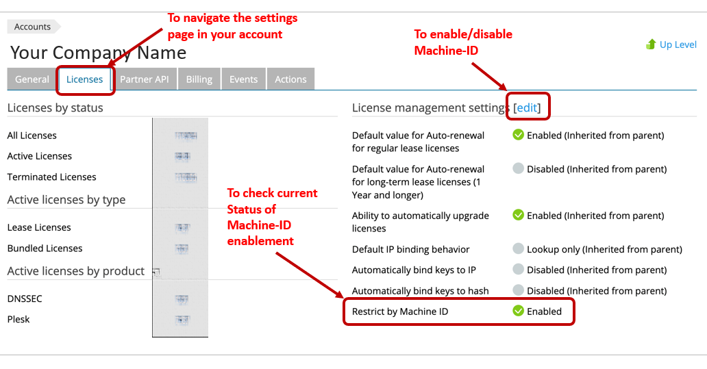

  • Activate Machine ID Restriction. This new tool provides better protection against multi-use. You can enable it on your account in KA Partner Central:
      • Go to your account settings
      • Open the “Licenses” tab
      • Enable the “Restrict by Machine ID” option.
      While this feature may not prevent billing issues in the current month, it will safeguard existing licenses further down the line as well as any newly acquired licenses. If you have any questions, please contact your sales representative.
