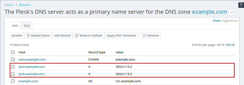

In this example, there is a duplicate DNS entry for example.com that points to the same IP address 203.0.113.2 at Domains > example.com > DNS Settings.
Screenshot_2018-12-24_The_Plesk_s_DNS_server_acts_as_a_primary_name_server_for_the_DNS_zone_example_com_-_Plesk_Onyx_17_8_11.png

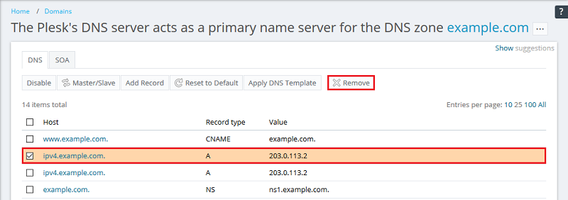

  2. Go to Domains > example.com > DNS Settings.
  3. Select the duplicate DNS entries and remove them.
    Note: If the domain's DNS zone is hosted externally (only NS records are shown), see the solution below.
  4. On the next page, click Update to apply the changes.
