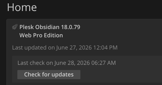

GoAccess is now the default web statistics tool starting on Plesk Obsidian 18.0.79.
Prior to Plesk version 18.0.79, you may need to install GoAccess from Plesk installer, which is available under Web Hosting option.

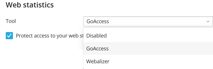

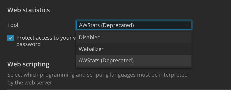

For one domain
  1. Log in to Plesk.
  2. Go Domains > example.com > Hosting Settings > Web scripting and statistics section**.**
  3. Select the required web statistics utility from the drop-down menu and click Ok

  • Kurt, I had to install GoAccess first. Its under the Webhosting tab in the Plesk Installer.It's
    1
  • I am not happy, because I don't have the option to select GoAccess.
    And yes I have the right version.
    Whats wrong here?
    0
  • Thanks. Done.
    But this hint should be added to this page.
    0
