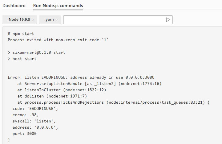

Symptoms
  • While trying to run a Node.js application for a domain by using the Node.js Toolkit extension for Plesk by going to Domains > example.com > Node.js > Run Node.js commands, an error that is similar to the following appears
CONFIG_TEXT: next start
info Visit https://yarnpkg.com/en/docs/cli/run for documentation about this command. Error: listen EADDRINUSE: address already in use 0.0.0.0:3000
at Server.setupListenHandle [as _listen2] (node:net:1774:16)
at listenInCluster (node:net:1822:12)
at doListen (node:net:1971:7)
at process.processTicksAndRejections (node:internal/process/task_queues:83:21)
Cause
Port 3000, which your Node.js application is attempting to use is already occupied by a service that the Premium Antivirus for Servers extension for Plesk uses:
# netstat -tulpn | grep :3000
tcp 0 0 127.0.0.1:3000 0.0.0.0:* LISTEN 1331/drwebd.real
