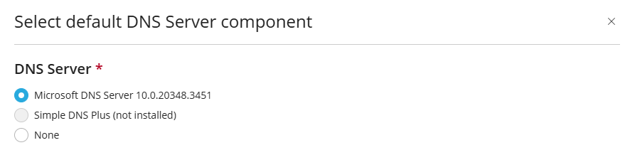

Go to Tools & Settings > Updates and install Microsoft DNS Server component if it is not installed.
Go to Tools & Settings > Server Components > DNS Server and select Microsoft DNS Server:
Press Save
Note: Plesk UI information at Tools & Settings > Server Components might be cached, so in order to see the DNS server change it is required to re-login to Plesk UI.
