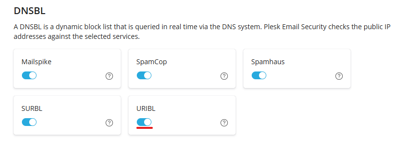

Local DNS server (for caching) is configured on the server and high volume of queries towards URIBL.
Sign up for a paid service tier directly on https://uribl.com in order to be allowed to make a "high volume" of queries from your server
Alternatively, disable the usage of the URIBL reputation list by following these steps:
  1. Log into Plesk
  2. Go to Extensions > My extensions> Plesk Email Security > Server Settings tab
  3. In Advanced > DNSBL, switch off the URIBL block list by moving its slider to the left
