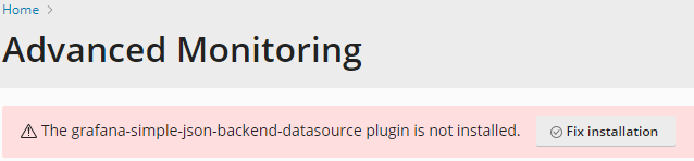

  6. If the following error message is shown at Advanced Monitoring, press Fix installation button:
