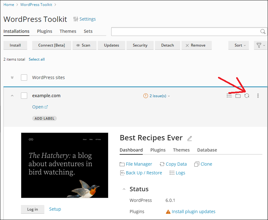

For one WP instance
  1. Log into Plesk.
  2. Go to WordPress > example.com.
  3. Press the refresh button that is highlighted on the screenshot below:
