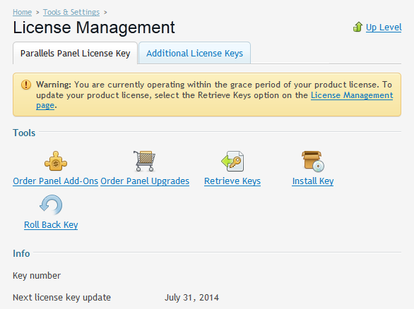

Symptoms
Error on the main Plesk page (and pretty much every other page):
PLESK_INFO: Warning: You are currently operating within the grace period of your product license. To update your product license, select the Retrieve Keys option on the License Management page.
However if Retrieve Keys button is pressed on the License Management page, the key is updated fine.
The error comes back on the next key update date.
