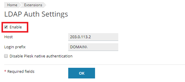

In case if it is needed to use both Plesk native authentication and LDAP Auth methods, enable LDAP Auth settings only at Extensions > LDAP Auth as it is shown below:

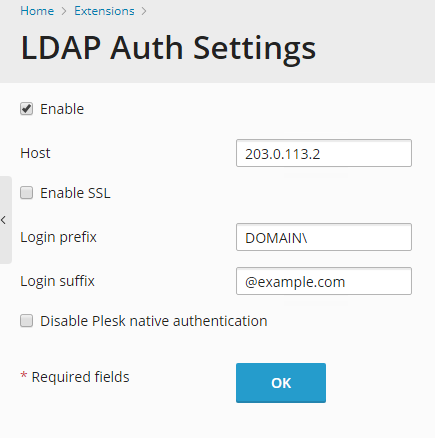

No additional configuration from OS level is required before installing the LDAP Auth extension. The only requirement is that Plesk should have the user with the same name as the one on LDAP server. For example, LDAP server has user jdoe with password password. Then it is required to create the same user in Plesk, configure extension and disable Plesk native authentication. After that it will be possible to log into Plesk as jdoe with password password.
Note: The type of the user is not related specifically to account type.
For Windows it is required to specify domain name with ending slash DOMAIN\ in "Login prefix" or a suffix such as @example.com.
