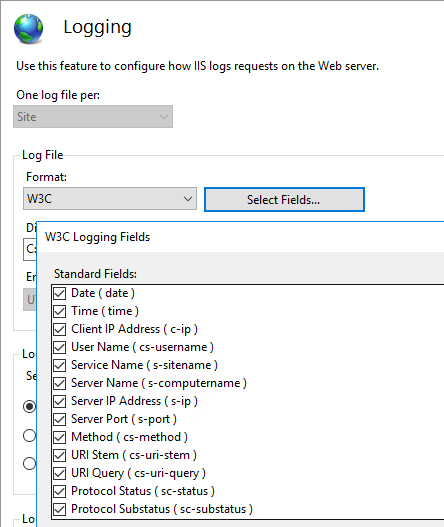

  2. Go to IIS > Sites > example.com > Logging and enable all fields for W3C logging:
