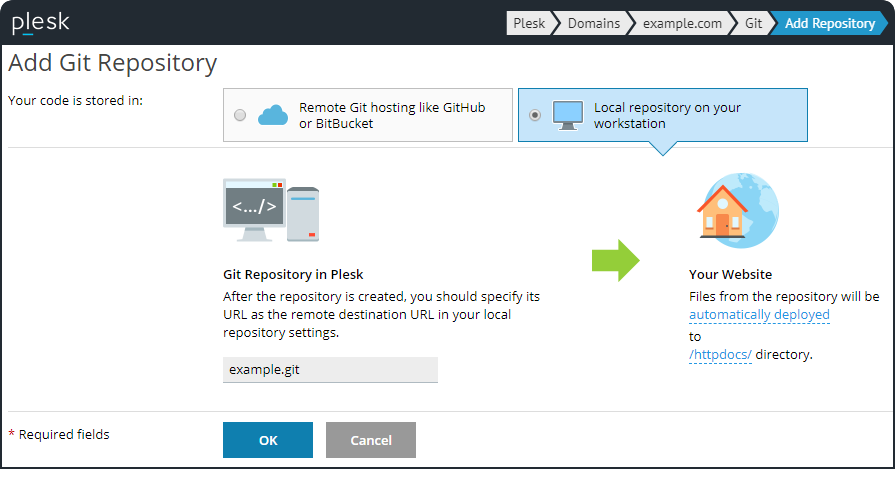

  2. Create a new local Git repository in Plesk > Domains > example.com > Git > Add Repository:

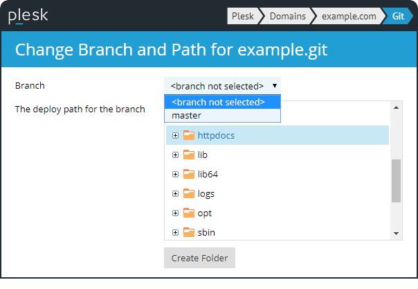

  7. Navigate to Plesk > Domains > example.com > Git and select master branch in Change branch and path:
    border_plus_2018-02-24_18_20_06-Git_Repositories_on_chtulhu.faith_-_Plesk_Onyx_17.5.3.png
