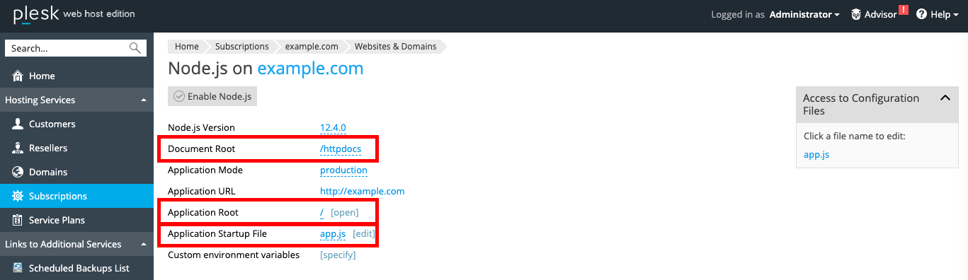

  3. Go to Domains > example.com > Create Website > Node.js and set the application configuration:
    • In Plesk for Linux: the Document Root directory must be the subdirectory of the Application Root directory:
      Click Install
      Note: app.js should be located in Application Root.
    • In Plesk for Windows: the Application Root directory must be same as the Document Root directory.
  4. Click NPM install and Run script if necessary.
