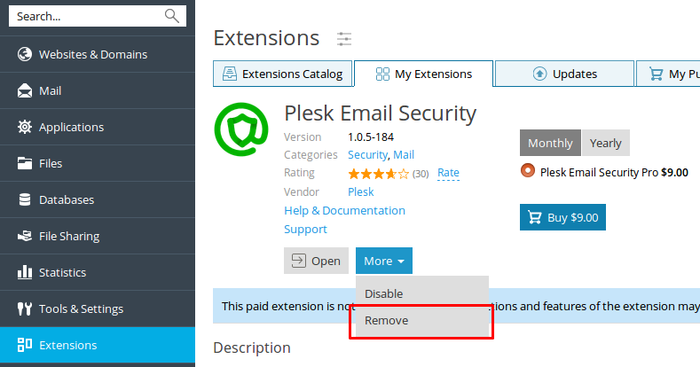

  2. Remove Plesk Email Security extension via Extensions > Plesk Email Security > More > Remove:

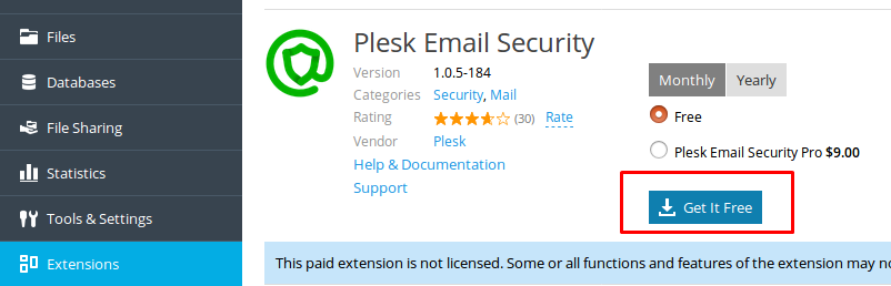

  6. Reinstall Plesk Email Security under Plesk > Extensions > Plesk Email Security > Get it Free:
