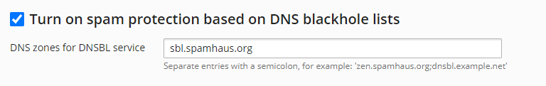

Disable DNSBL queries on Plesk server by unchecking the Turn on spam protection based on DNS blackhole lists checkbox at Tools & Settings > Mail Server Settings.

Configure Plesk server to use a different DNSBL service that does not forces us to access it via non-public DNS resolvers:
dnsbl.info
;spamcop.net
;spam.abuse.net
Switch to using Spamhaus DQS (Data Query Service) as a way to access the DNSBL service. The drawback of this approach is that it requires you to contact Spamhaus to get an access key. More information can be found here.
