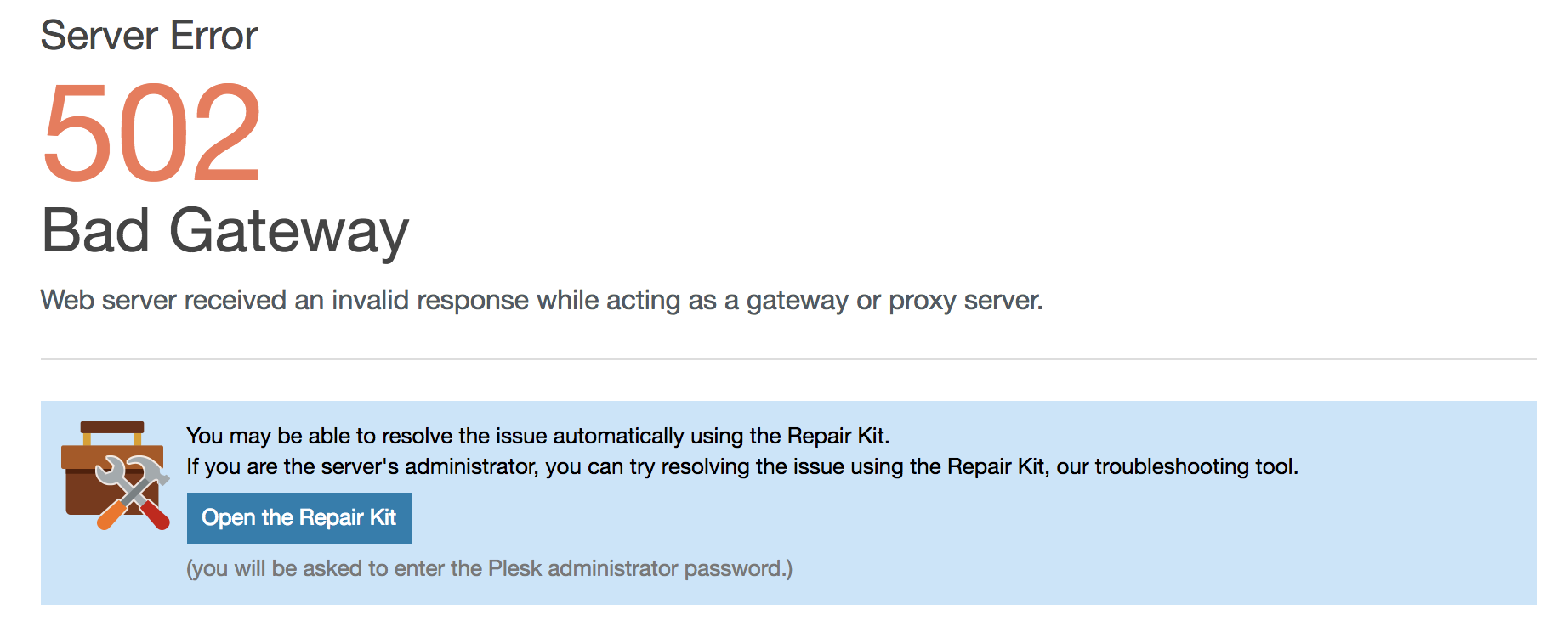

  • Plesk shows 502 Bad Gateway error

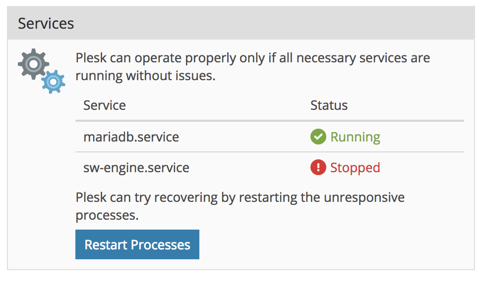

  • The service sw-engine is not running:

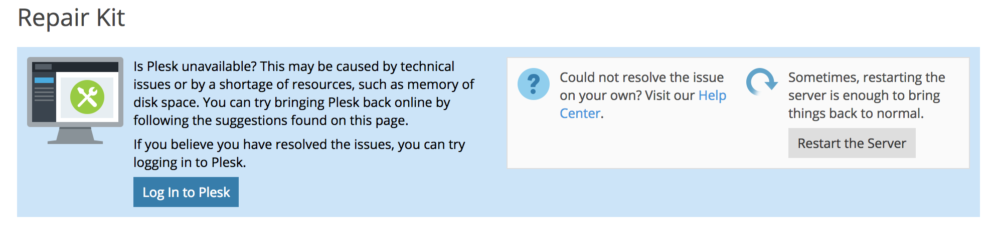

    1. Click Open Repair Kit and log in with Plesk admin credentials.
      Repair Kit

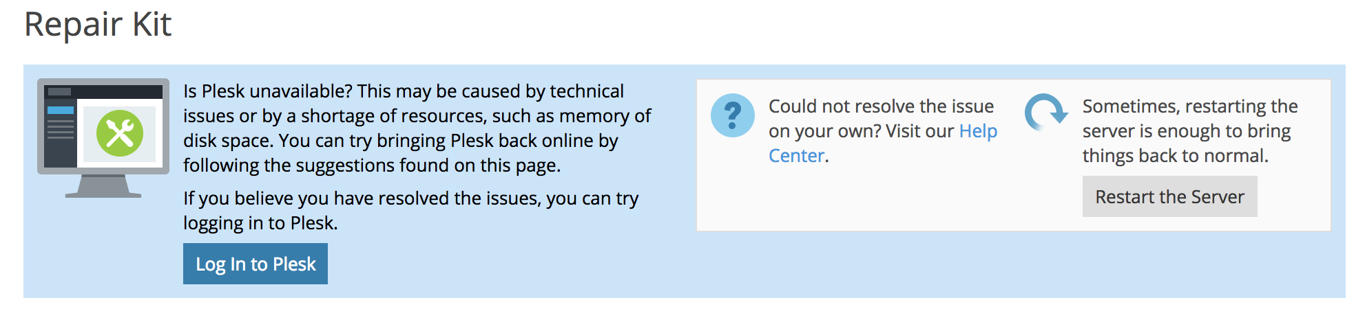

    2. If it was successful, try starting sw-engine service by clicking Restart Processes
      Repair Kit
    3. If it was successfully started, click Log In to Plesk button
