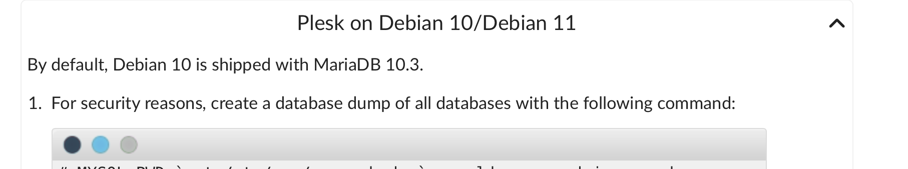

Plesk on Debian 10/Debian 11
By default, Debian 10 is shipped with MariaDB 10.3.
  1. For security reasons, create a database dump of all databases with the following command:
    # MYSQL_PWD=`cat /etc/psa/.psa.shadow` mysqldump -u admin --verbose --all-databases --routines --triggers > /root/all-databases.sql
  2. Stop MariaDB:
    # service mariadb stop
Here is an example for MariaDB 10.4:
