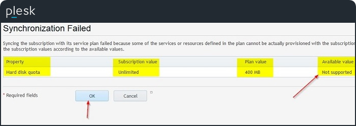

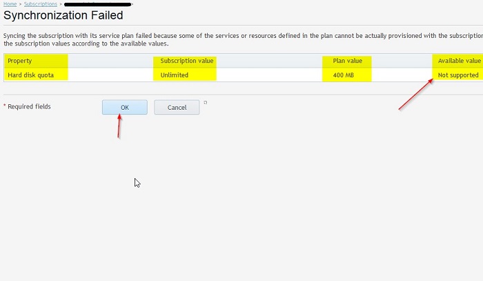

  • Subscription cannot be synchronized with the corresponding service plan due to the following error:
    PLESK_INFO: Syncing the subscription with its service plan failed because some of the services or resources defined in the plan cannot be actually provisioned with the subscription.
    PLESK_INFO: "Information: Properties of the subscription example.com were set to correspond with the actual system state, they are still unsynced with the plan"
    Available value indicates the actual state of a resource or a service in the system.
    Clicking OK will initiate setting the subscription values according to the available values.
    OR:
    PLESK_ERROR: ERR [panel] Unable to apply plan changes to domain. Error: The plan was not applied because of problems with the following functionality: hard disk quota is not supported due to configuration of server file system
