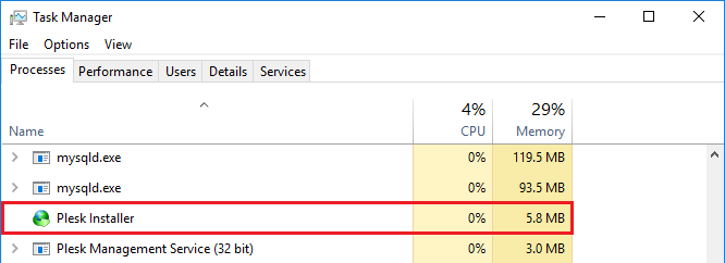

Terminate Plesk Installer processes using Windows Task Manager
Open Task Manager (Open Windows Start > type "Task Manager")
Right-click on each existing "Plesk Installer" process and click End Task:
Note: Plesk Installer processes can have one of the following names depending on Plesk version: Plesk Installer, ai.exe, parallels-installer.exe or plesk-installer.exe.
