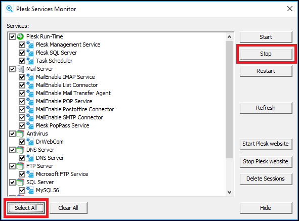

  1. Open Plesk Services Monitor, click the Select All and then the Stop button in order to stop all Plesk services:

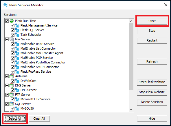

  10. Open Plesk Services Monitor, click the Select All and then the Start button in order to start all Plesk services:

  9. Open Plesk Services Monitor, click the Select All and then the Start button in order to start all Plesk services:

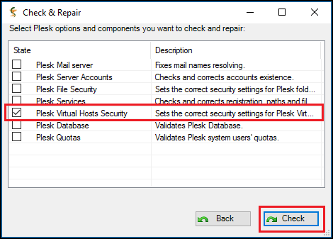

  17. Run Plesk Reconfigurator, click the Repair Plesk Installation button, mark the Plesk Virtual Hosts security checkbox only and click the Check button in order to recreate systems users and restore their permissions:

  1. Stop all Plesk services in Plesk Services Monitor:

  10. Start Plesk services in Plesk Services Monitor

  16. Run Plesk Reconfigurator and perform Repair Plesk Installation > Plesk Virtual Hosts security - it recreates systems users and restores permissions.
