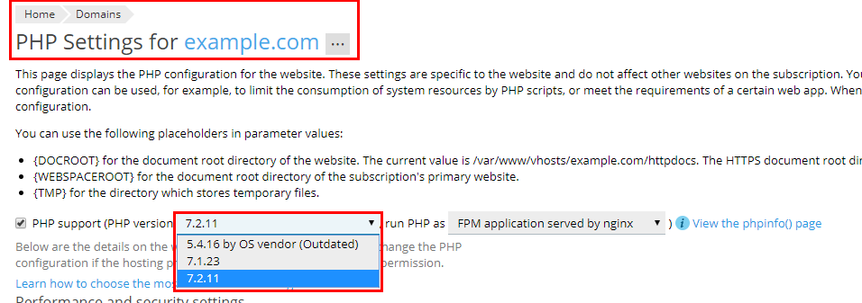

Via Plesk Interface
Go to Subscriptions > example.com > Websites & Domains > Hosting Settings > PHP version.
Now select the wanted PHP Version, for example, 7.2.11, then scroll down and press OK:
Note: This method will also change the PHP Versions of existing subscriptions if the Common PHP settings management permission is not set.

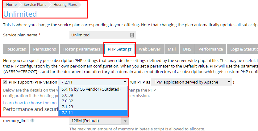

Go to Service Plans select the wanted Service Plan, for example, Unlimited and select the tab PHP Settings.
Note: The steps have to be repeated for each Service Plan, in which the PHP Handler should be updated.

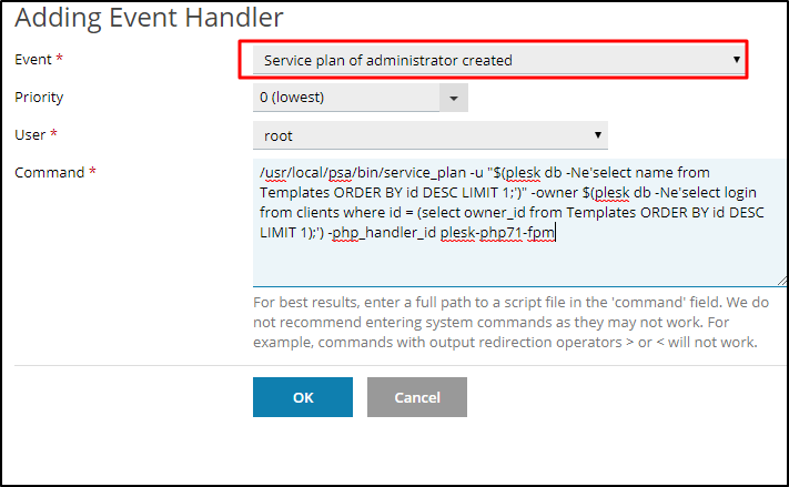

As a workaround it is possible to create 2 event handlers (for service plans created by the administrator and by resellers), which will setup wanted PHP version and handler for future service plans:
In Plesk go to Tools & Settings > Event Manager and click Add Event Handler
Select the event Service plan of administrator created and paste the command below to the Command field:
CONFIG_TEXT:/usr/local/psa/bin/service_plan -u "$(plesk db -Ne'select name from Templates ORDER BY id DESC LIMIT 1;')" -owner $(plesk db -Ne'select login from clients where id = (select owner_id from Templates ORDER BY id DESC LIMIT 1);') -php_handler_id plesk-php71-fpm
Create an additional event handler for Service plan of reseller created and paste the command below to the Command field:
CONFIG_TEXT:/usr/local/psa/bin/service_plan -u "$(plesk db -Ne'select name from Templates ORDER BY id DESC LIMIT 1;')" -owner "$(plesk db -Ne'select login from clients where id = (select owner_id from Templates ORDER BY id DESC LIMIT 1);')" -php_handler_id plesk-php71-fpm
Note: Instead of plesk-php71-fpm it is possible to use a different PHP handler, which is displayed in the PHP Handler list, which can be viewed by following the steps in Retrieve the PHP Handler table
