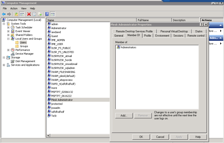

  2. Make sure that "Plesk Administrator" user belongs to "Administrators" group:
    • Hit Win + r on the keyboard, type compmgmt.msc in the Run window, and then press "ENTER".
    • Go to Local Users and Groups > Users > right click on Plesk Administrator > Properties > Member Of.
      If "Plesk Administrator" doesn't belong to "Administrators" group, add it using Add... button and type "Administrators".

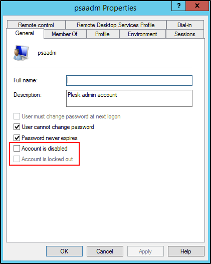

  3. Open Properties for psaadm user and disable the options Account is disabled and Account is locked out if they are enabled.

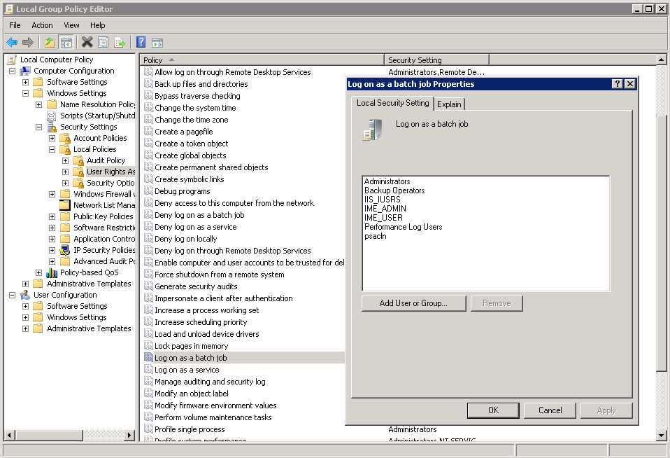

  4. Make sure that "Administrators" group is added to "Log on as a batch job":
    • Hit Win + r on the keyboard, type gpedit.msc in the "Run" box, and then press "ENTER".
    • Go to Local Group Policy Editor > Computer Configuration > Windows Settings > Security Settings > Local Policies > User Rights Assignment > Log on as a batch job .
      Make sure that "Administrators" group is added, add it if it is required.
  5. Ensure that "Everyone", "Plesk administrator", "Administrators" groups, psaadm user are not listed in Local Group Policy Editor > Computer Configuration > Windows Settings > Security Settings > Local Policies > User Rights Assignment > Deny log on as a batch job .
