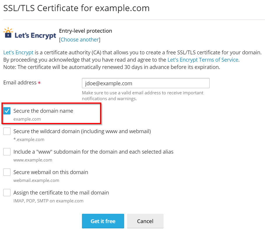

  • Secure only main domain, e.g example.com:
    1. Log into Plesk.
    2. Open Domains > example.com > SSL/TLS Certificates > Install(at the bottom) and leave only Secure the domain name checkbox toggled and issue the certificate:
