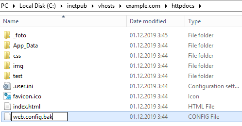

  2. Rename the web.config file to web.config.bak in the example.com\httpdocs folder via Windows Explorer or the Plesk File Manager:

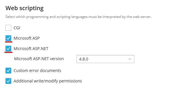

  3. Log into Plesk, go to Domains > example.com > Hosting & DNS > Hosting > Web scripting and uncheck the boxes for Microsoft ASP and Microsoft ASP.NET support in order to disable them:
  4. Scroll down and press Save

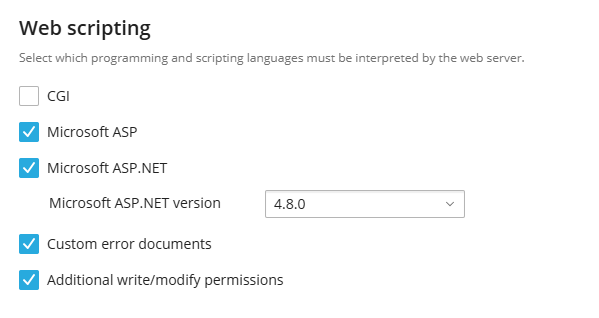

  7. Go to Domains > example.com > Hosting & DNS > Hosting > Web scripting and check the boxes for Microsoft ASP and Microsoft ASP.NET support in order to enable them again
  8. Scroll down and press Save

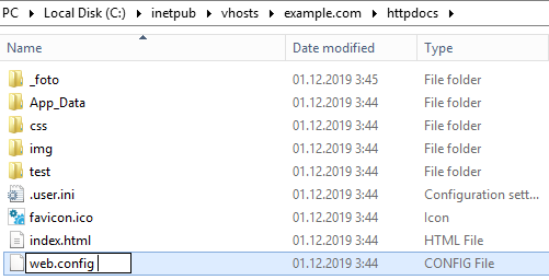

  9. Rename the web.config.bak file back to web.config via Windows Explorer or the Plesk File Manager
