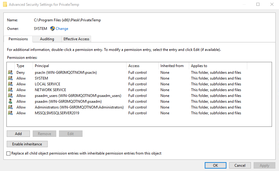

Incorrect permissions on C:\Program Files (x86)\Plesk\PrivateTemp or the folder is missing.
Resolution
  1. Connect to the server via RDP
  2. Check if the necessary directory exists (paste the line %plesk_dir%PrivateTemp to the address bar of the Windows Explorer)
  3. Restore permissions on the directory to the default values:
