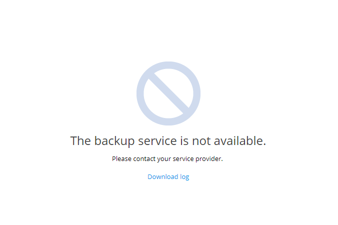

Symptoms
  • Plesk > Acronis Backup fails with the following error:
    CONFIG_TEXT: The backup service is not available.
    Please contact your service provider.
    Click Install
