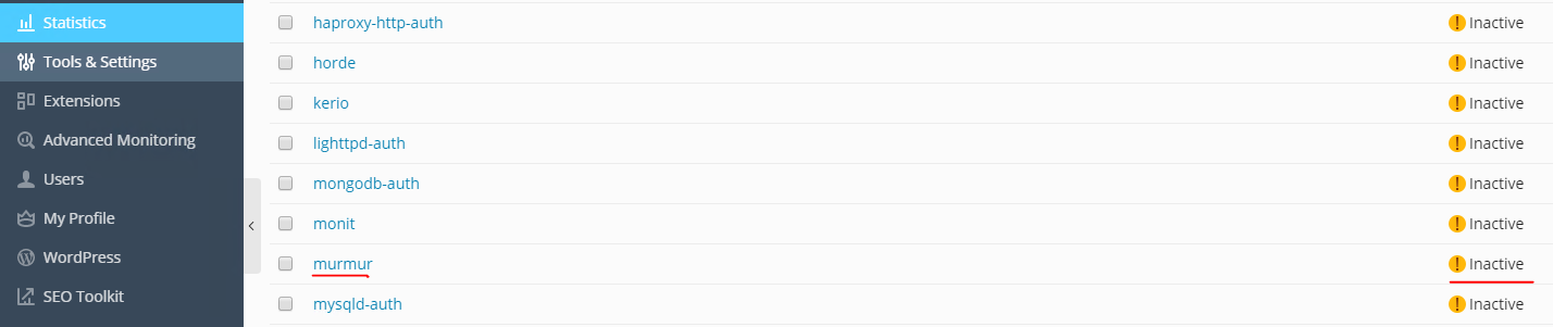

  1. Log into Plesk
  2. Go to the Tools & Settings > IP Address Banning.
  3. Switch off the unnecessary jail/jails:
  4. Start Fail2Ban at Tools & Settings > Services Management.
