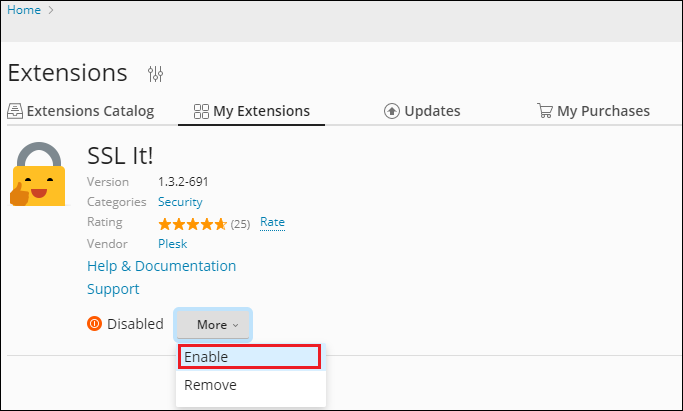

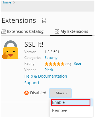

Enable SSL It! extension
  1. Log into Plesk.
  2. Go to Extensions > My Extensions > SSL It!.
  3. Press More and then Enabled button:
