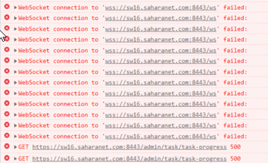

Plesk panel is slow: Plesk menus take a considerable amount of time to load.
Browser DevTools (F12) shows the following errors under Console tab:
Failed to load resource: the server responded with a status of 404 (Not Found)
:8443/manifest.webmanifest?1607564336:1 Manifest: Line: 1, column: 1, Syntax error.
WebSocket connection to 'wss://example.com:8443/ws' failed: Error during WebSocket handshake: Unexpected response code: 502

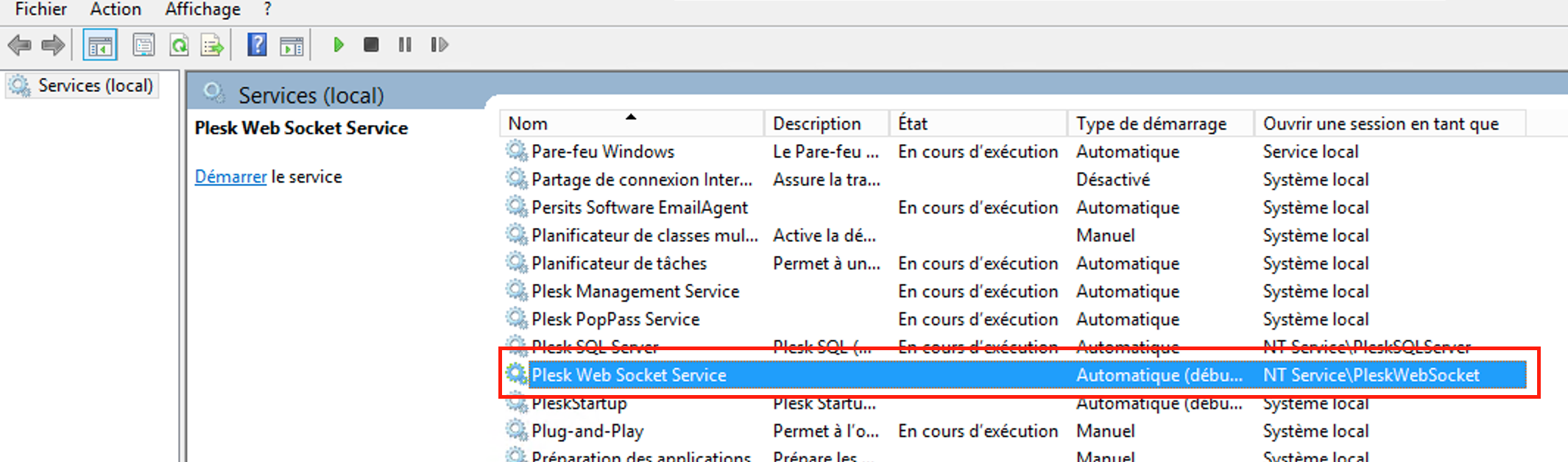

Connect to the server via RDP.
Go to Windows Start > Services page and restart
PleskWebSocket
service by right-click onPleskWebSocket
> Restart. -
