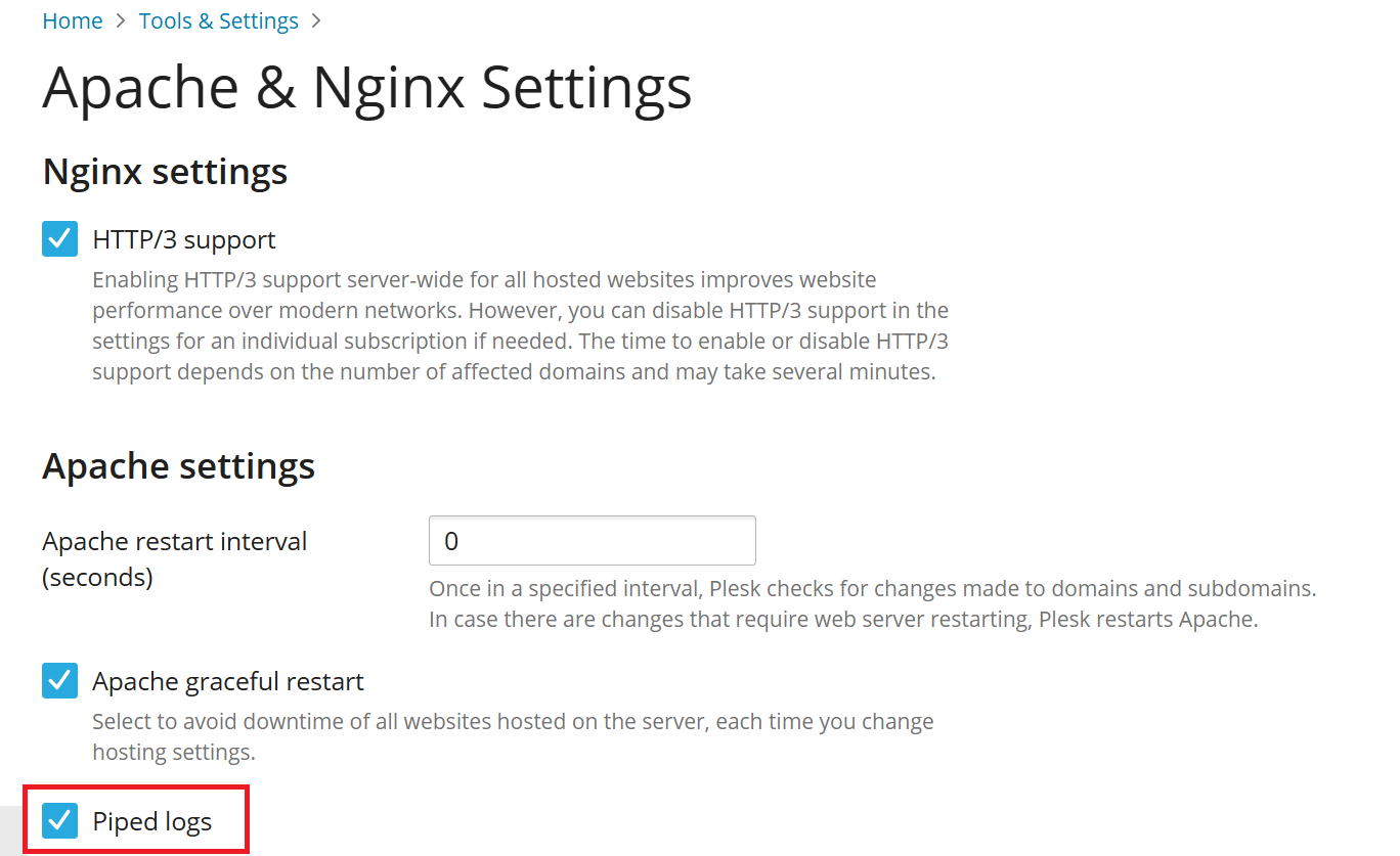

Symptoms
  • Plesk version is 18.0.76.0
  • Plesk panel shows error:
    PLESK_ERROR: Error: Can not reconfigure web server configurations: Unable to execute httpdmng: [2026-02-17 20:54:18.047] 996608:6994c76a0b84b ERR [util_exec] proc_close() failed ['/opt/psa/admin/bin/apache-config' '-t'] with exit code [1]
    [2026-02-17 20:54:18.145] 996608:6994c76a0b84b ERR [panel] Apache config (17713580570.92369400) generation failed: Template_Exception: AH00526: Syntax error on line 15 of /etc/apache2/plesk.conf.d/server.conf:
    Invalid command 'plesklog', perhaps misspelled or defined by a module not included in the server configuration
  • Regenerating web server configurations with plesk repair web -y fails with the following error:
    CONFIG_TEXT: [FAILED]
    - httpdmng failed: Execution failed.
    Command: httpdmng
    Arguments: Array
    [0] => --reconfigure-server
    [1] => -no-restart
    Details: [2026-02-17 22:32:45.678] 1168076:6994de7da575c ERR
    [2026-02-17 22:32:45.765] 1168076:6994de7da575c ERR [panel]
    Apache config (17713639650.55293900) generation failed:
    file:
    /opt/psa/admin/plib/Template/Writer/Webserver/Abstract.php
    line: 75
    code: 0
  • In Tools & Settings > Apache & nginx Settings, the Piped logs option is enabled:
Cause
Product issue:
  • #PPPM-15302 "Fixed the issue where, after updating to Plesk Obsidian 18.0.76, the “Invalid command ‘plesklog’” error was shown if piped logs were enabled for Apache."
    Fixed in:
Resolution
Please consider updating your server:
Workaround
If update is not possible for some reason you may try the following
workaround
As a workaround, disable Piped logs:
  1. Log into Plesk
  2. Go to Tools & Settings > Apache & nginx Settings
  3. Uncheck the box for Piped logs
  4. Press OK
