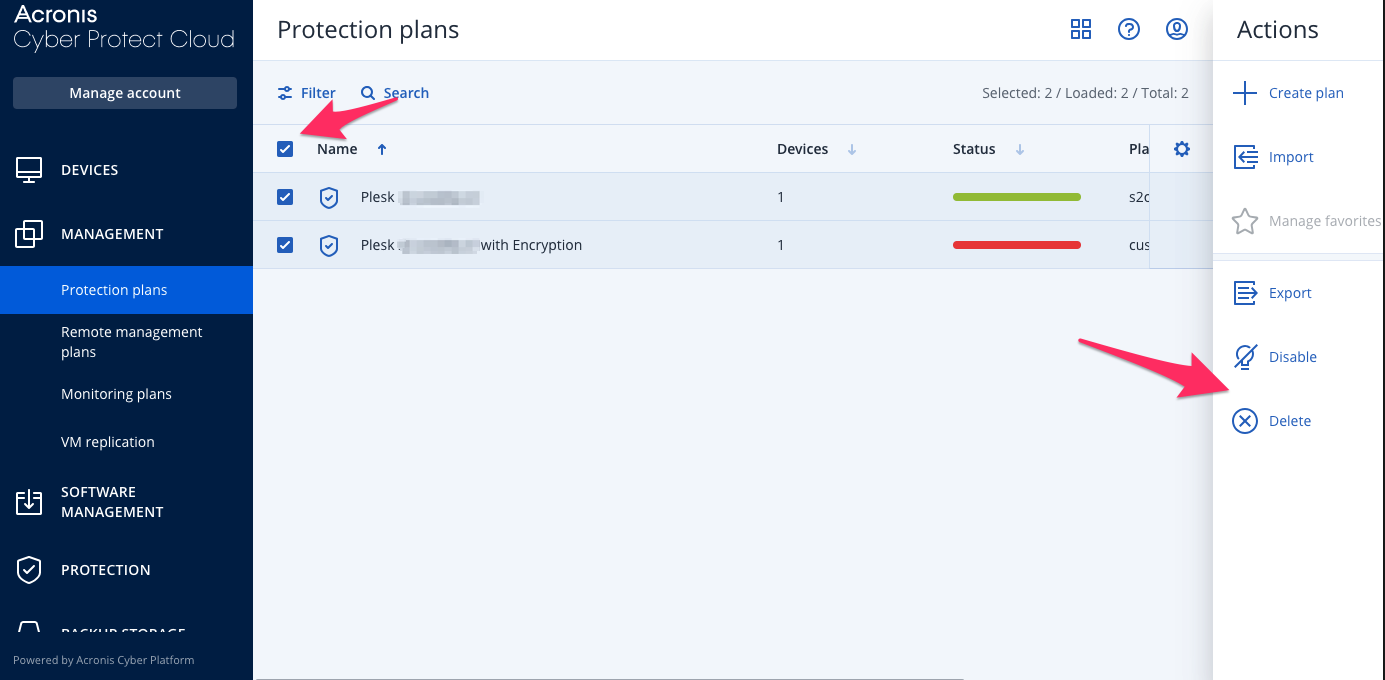

  1. Log in to Backup Console directly via cloud.acronis.com
  2. Delete or disable the Protection Plans from the console in Management > Protection Plans (backups will not be deleted):
  3. Remove and install again the Acronis Backup Extension
  4. Open Acronis Backup in Extensions > Acronis Backup
  5. Reauthenticate your username and password used to access the Backup Console Utility
  6. Execute the backup again.
