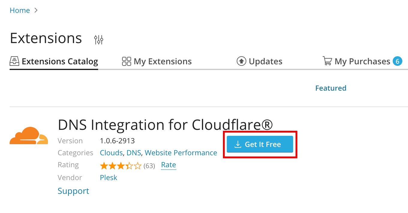

3. Search for and install the DNS Integration for Cloudflare® extension

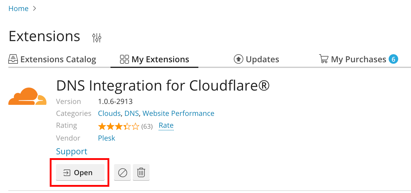

4. Press Open on the page of the DNS Integration for Cloudflare® extension

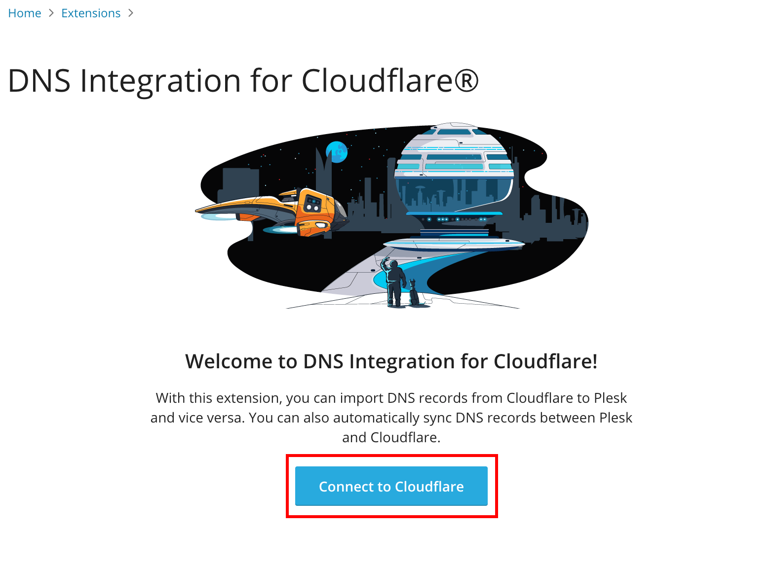

5. Press on Connect to Cloudflare

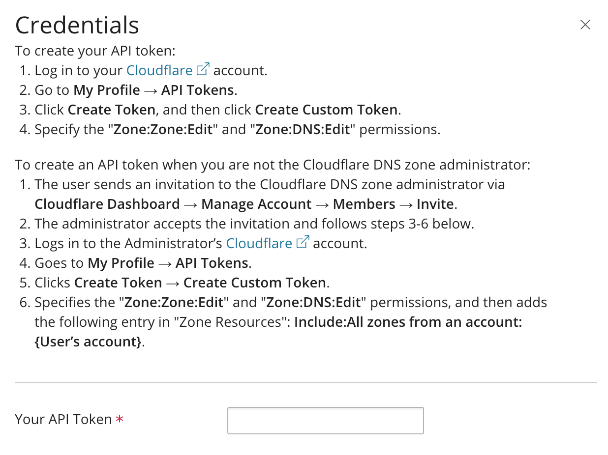

6. Follow the instructions, and once you acquire your Cloudflare API token from the cloudflare.com website, enter it in the field:
7. Press Save
