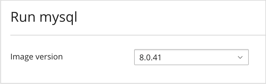

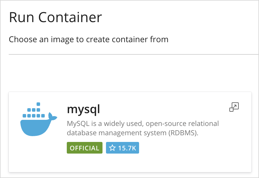

  5. Click Run Container and search for mysql.
  6. Select required version and click Next. In this example, we are installing MySQL version 8.0.
  7. Click Next. The image download will begin.

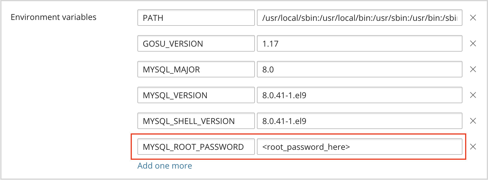

    • In Environment variables section, click Add one more and add MYSQL_ROOT_PASSWORD to Variable and your root password to Value.
      Note: Keep default environment variables as-is.

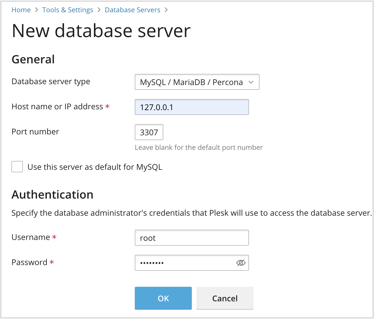

  10. Once container is started, go to Tools & Settings > Database Servers and click Add Database Server.
  11. Fill in the fields:
    • Host name or IP address: 127.0.0.1
    • Port number: 3307
    • Username: root
    • Password: your_root_password
  12. Click OK.
