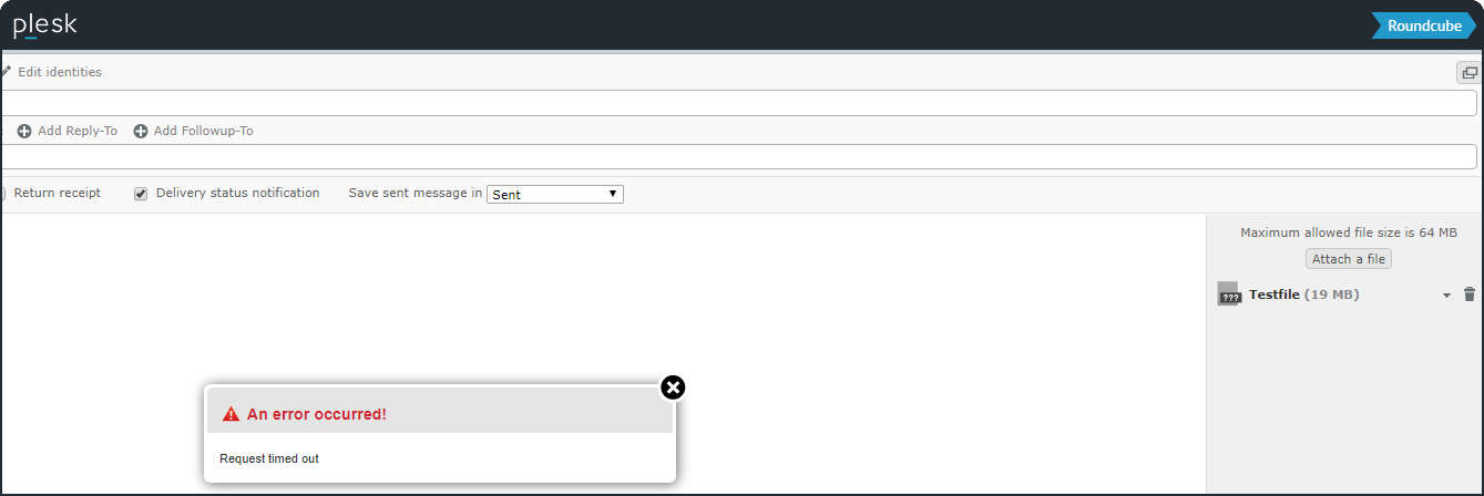

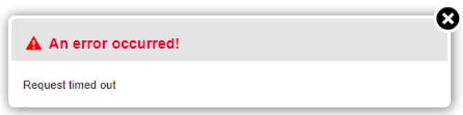

Symptoms
  • RoundCube shows error when sending email with attachment with file size more than 20 MB. The following error appears in Plesk UI:
  • Emails are delivered regardless the above error.
  • Plesk > Tools & Settings > Mail server settings > Maximum message size value is set to 20 MB or more.
