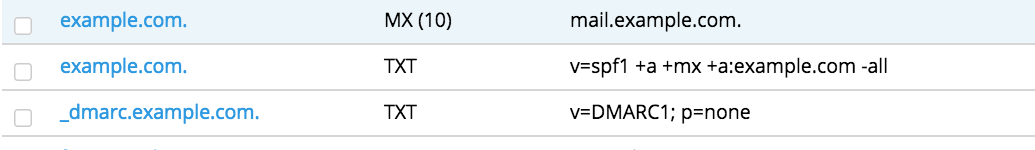

To check that DNS server has information about SPF for domain
example.com
, use thedig
utility:# dig -t TXT +short example.com @13.23.33.43
"v=spf1 +a +mx -all +a:server.hostname.tld"where
13.23.33.43
IP address of theserver.hostname.tld
where DNS server is running.
Note: The SPF information can be written in either TXT format or as a dedicated SPF record. The latter is also sometimes referred to as a "type99" record. The SPF information needs to be in at least one of these formats. If both are used, these records must be exact copies of each other. These records are served by the same DNS server that serves example.com
domain name.

If there is no SPF DNS record found after the test, configure it in accordance with the guide below:
