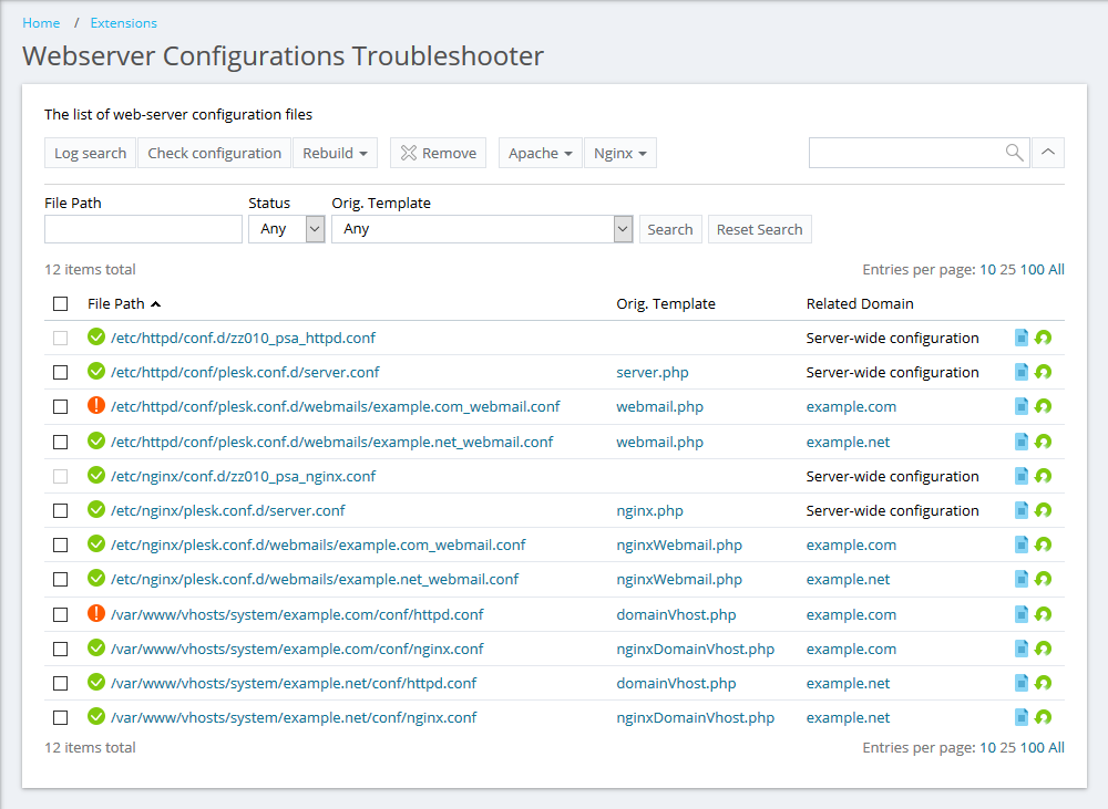

To begin, open Web Server Configurations Troubleshooter.
  1. On the main page appears the list of all configuration files generated by Plesk. The green mark Red_mark.png indicates that configuration file is successful and the red mark Red_mark.png indicates an error.

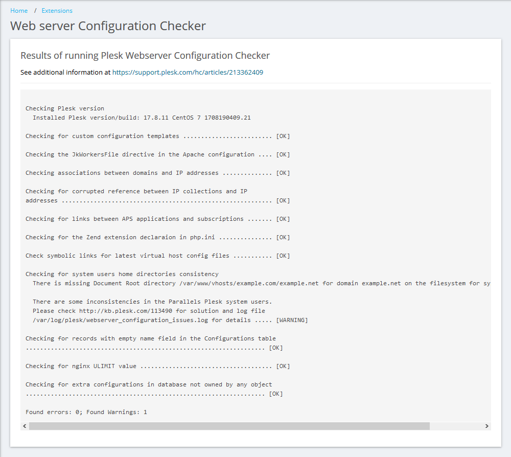

  2. To check whether there are known issues related to the generation of web-server configuration files, click Check configuration.
    This button starts a script that detects the most frequent issues related to the regeneration of web-server configuration files. For every detected issue, the script shows a link to the KB article that describes how to solve the issue. Visit the suggested articles and try applying their solutions.

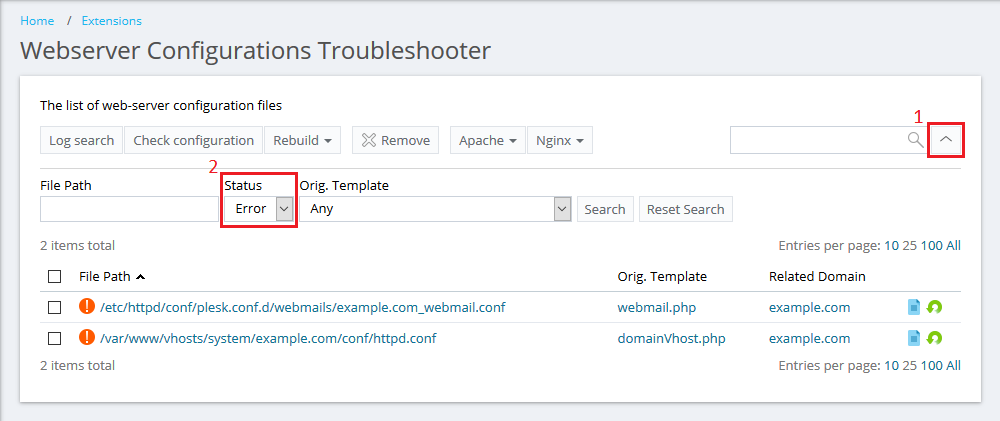

  3. Filter out faulty configurations by clicking on the Screenshot_2019-05-15_Webserver_Configurations_Troubleshooter_-_Plesk_Onyx_17_8_11_4_.png button, then setting Status to "Error" from the drop-down menu. This will help you determine the websites for which configuration file generation failed.
    Here, you also can go to the corresponding subscription using the links in the Related Domain column.
    Screenshot_2019-05-15_Webserver_Configurations_Troubleshooter_-_Plesk_Onyx_17_8_11_5_.png
  4. Select all, then click Rebuild > Broken.
    Webserver Configurations Troubleshooter will try to regenerate broken configuration files. If any issues to be encountered, a message will appear indicating the exact error.

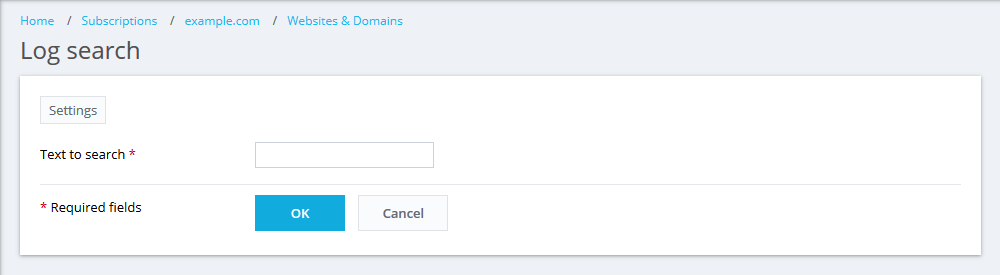

  5. If you did not find any errors, try finding error messages indicating the reasons for failure. Search for error messages in Plesk and web servers logs. To do this, click Log search.
    For example, you can search for the most common errors by typing any of these words:
    • fail
    • denied
    • No such
    • error
    Searching by these words also is performed in the Plesk log files. For this reason, a huge number of search results may be displayed, and the results might not be related to the issues with regenerating web-server configuration files. However, by performing such a search, you can reveal issues with additional malformed configuration directives for custom per-site PHP settings. For example:
    PLESK_INFO: ERR (3): phpinimng failed: Cannot parse php.ini: (<class 'ConfigParser.ParsingError'>, File contains parsing errors: <stdin> [line 11]: 'mbstring.substitute_character ""\')
