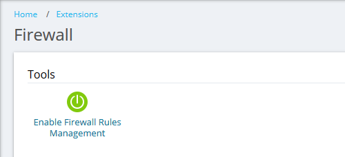

Log in to Plesk and go to Tools & Settings > Firewall and click Enable Firewall Rules Management.

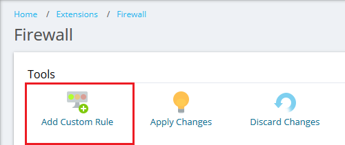

If the rule does not exist, create it:

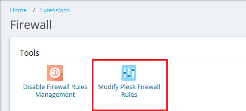

2.1. Click Modify Plesk Firewall Rules.
2.2. Click Add Custom Rule.
2.2. Configure the rule:

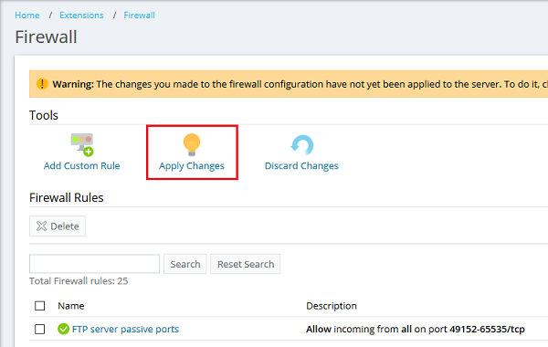

In the Add port or port range field, specify the configured passive port range 49152-65535 and select the TCP option.
2.3. Click OK to create the rule.
2.4. Next, click Apply Changes.
