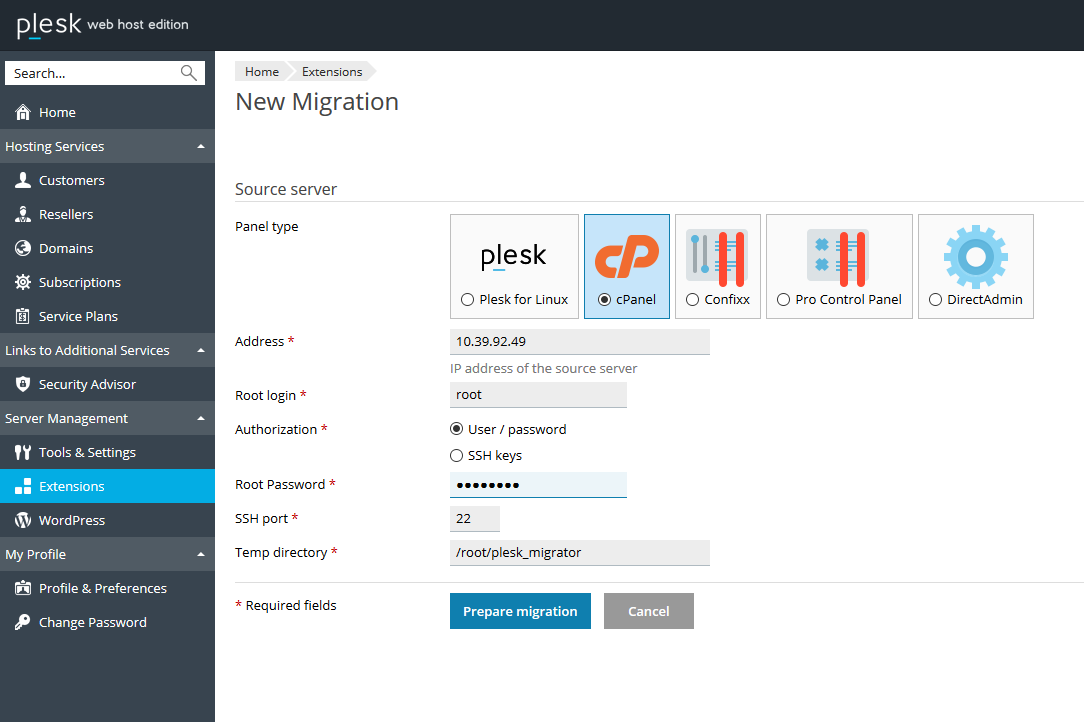

  5. Switch to cPanel and enter the source server's IP address (replace the example below with the real source server IP), specify the SSH port as well (22 by default), the login and password of a root user on the source server:
  6. Click Prepare Migration. Read about further steps in Plesk Migration Guide.
