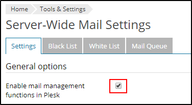

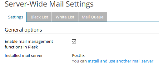

  2. Open Tools&Settings > Updates and Upgrades to make sure that all components were installed, including mail server. Make sure that mail service is enabled in Tools&Settings > Mail Server Settings:
    Note: even if mail service is enabled, disable it and enable again.

  2. Open Tools & Settings > Updates and Upgrades to make sure that all components were installed, including mail server. Make sure that mail service is enabled in Tools&Settings > Mail Server Settings:
