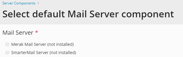

  • In Tools & Settings > Server Components > Mail Server the following can be seen:
    SmarterMail Server (not installed)
    mceclip0.png.
