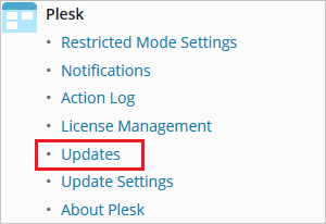

  1. Log in to Plesk.
  2. Go to Tools & Settings and click Updates.
  3. On the Updates page, click Install or Update Product:
  4. Click Continue on the Install or Update Product page to start Plesk update.
