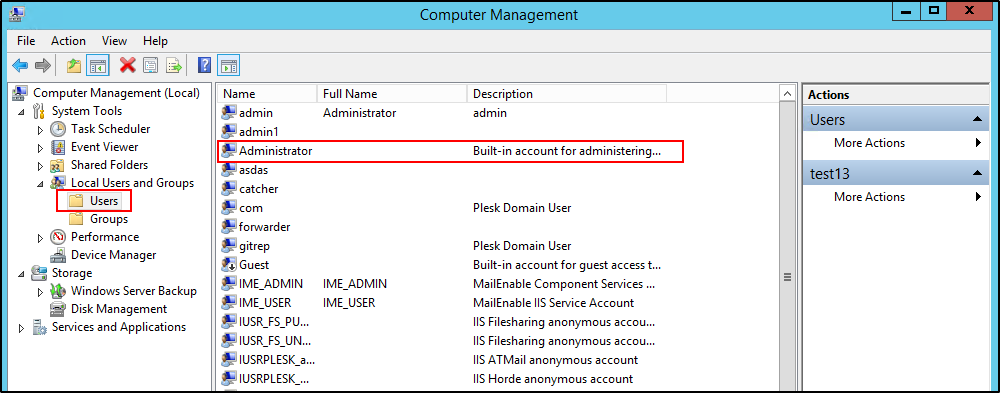

Start migration using built-in Windows Administrator account. Built-in Windows Administrator is configured in Control Panel > Administrative Tools > Computer Management > Local Users and Groups > Users.
