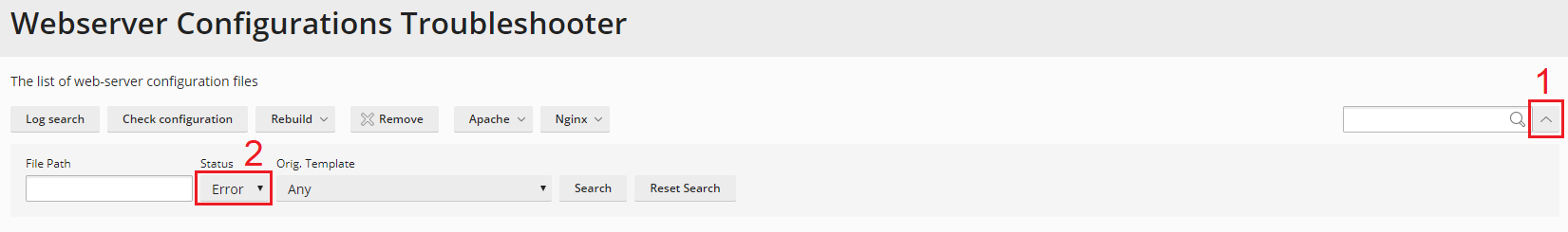

Remove the old information via Plesk:
  1. Log in to Plesk.
  2. Go to Tools & Settings > Webserver Configurations Troubleshooter.
    Note: If Webserver Configurations Troubleshooter is not shown, install it using Plesk Installer.
  3. Click the mceclip1.png button > set Status search filter to Error from the drop-down menu:
  4. The list of broken configuration files will appear. Select all, then click Rebuild > Selected.
  5. If configuration files could not be repaired, select them and click Remove.
  6. Click Check configuration to make sure there is no broken configuration left.
