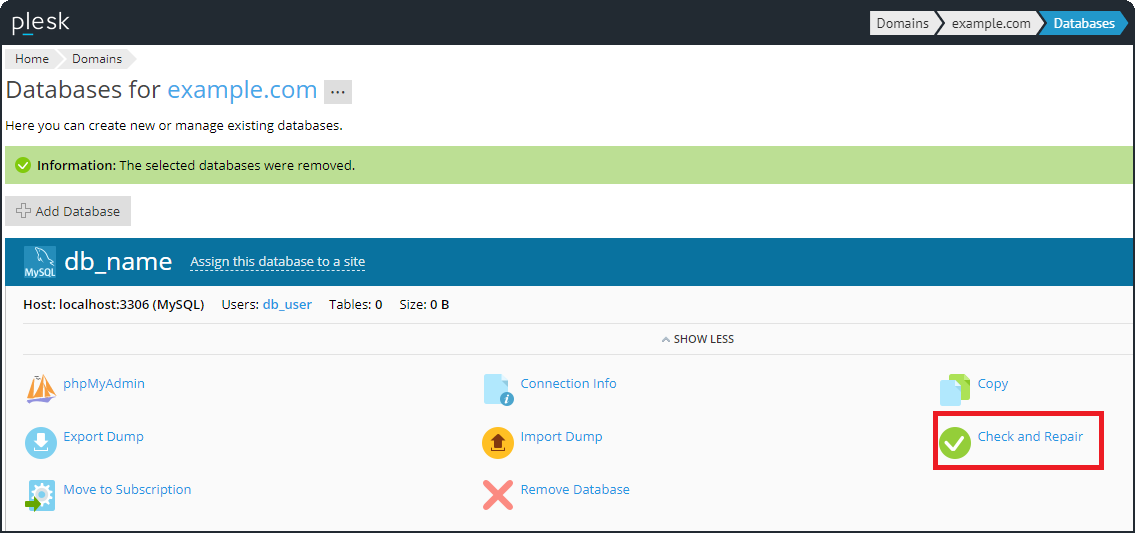

Via Plesk GUI
  1. Log in to Plesk
  2. Navigage to Plesk > Domains > example.com > Databases > db_name and click Check and Repair:

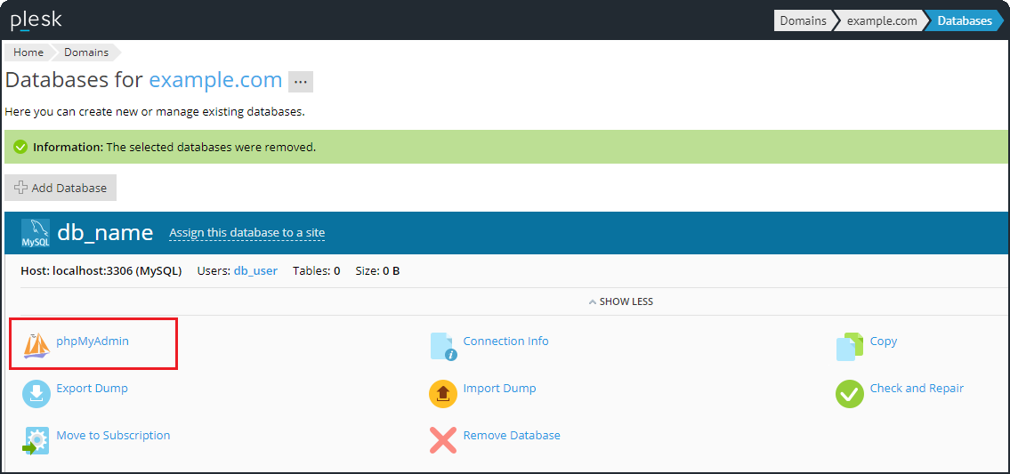

  1. Log in to Plesk;
  2. Navшgate to Plesk > Domains > example.com > Databases > db_name and click phpMyAdmin:

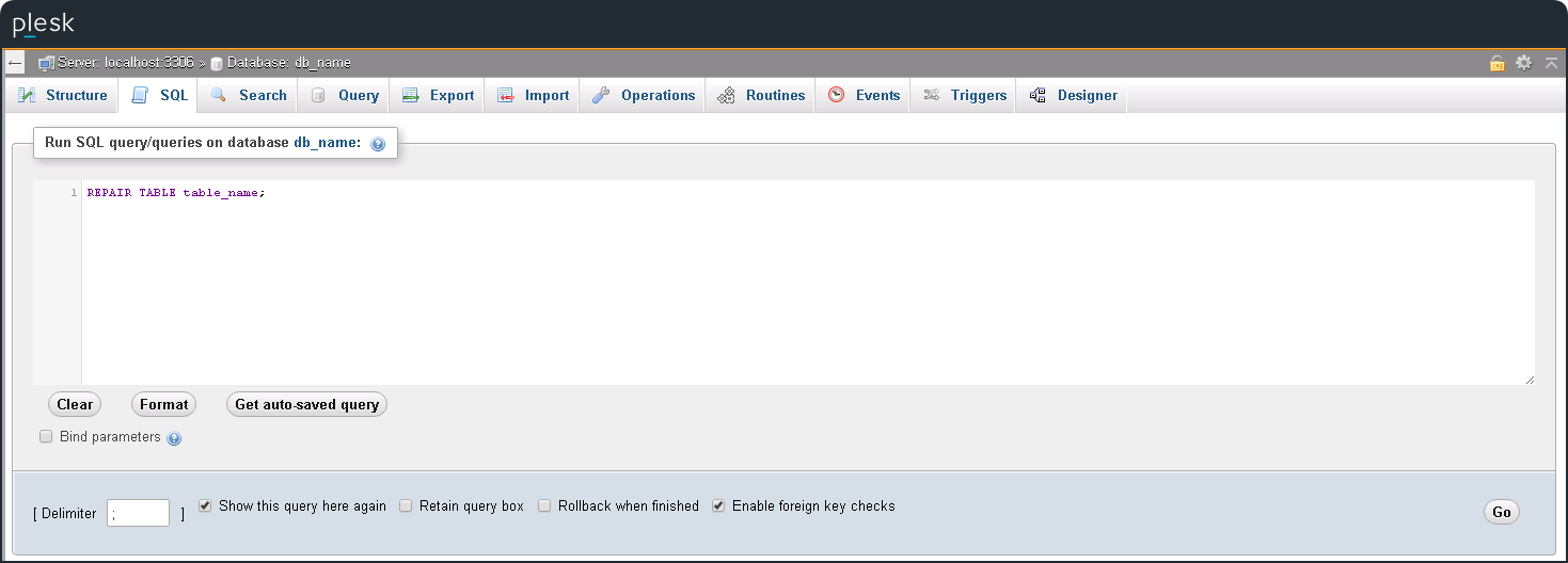

  3. Click SQL button and run the following query:
    CONFIG_TEXT: REPAIR TABLE table_name;
    Where table_name is the name of the table to repare
