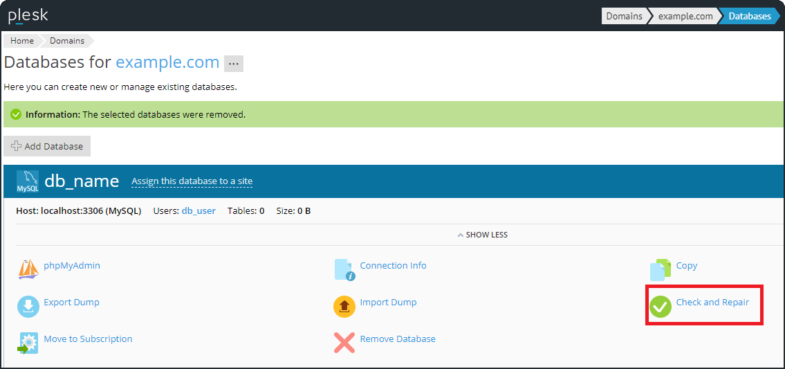

Via Plesk GUI
  1. Log into Plesk
  2. Go to Domains > example.com > Databases > db_name and click Check and Repair:

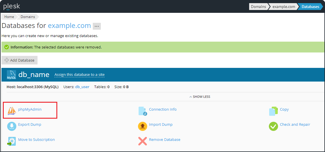

Via PHPMyAdmin
  1. Log into Plesk
  2. Go to Domains > example.com > Databases > db_name and click phpMyAdmin:

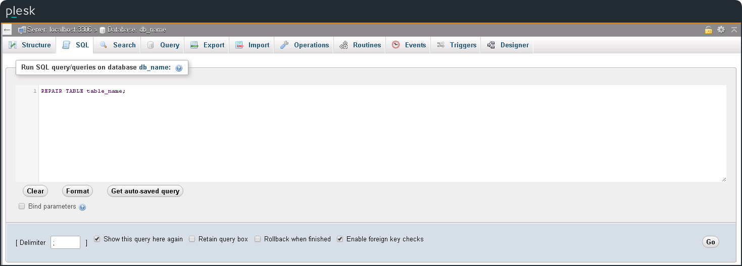

  3. Click SQL button and run the following query:
    CONFIG_TEXT: REPAIR TABLE table_name;
    Note: Where table_name is the name of the table to repare
