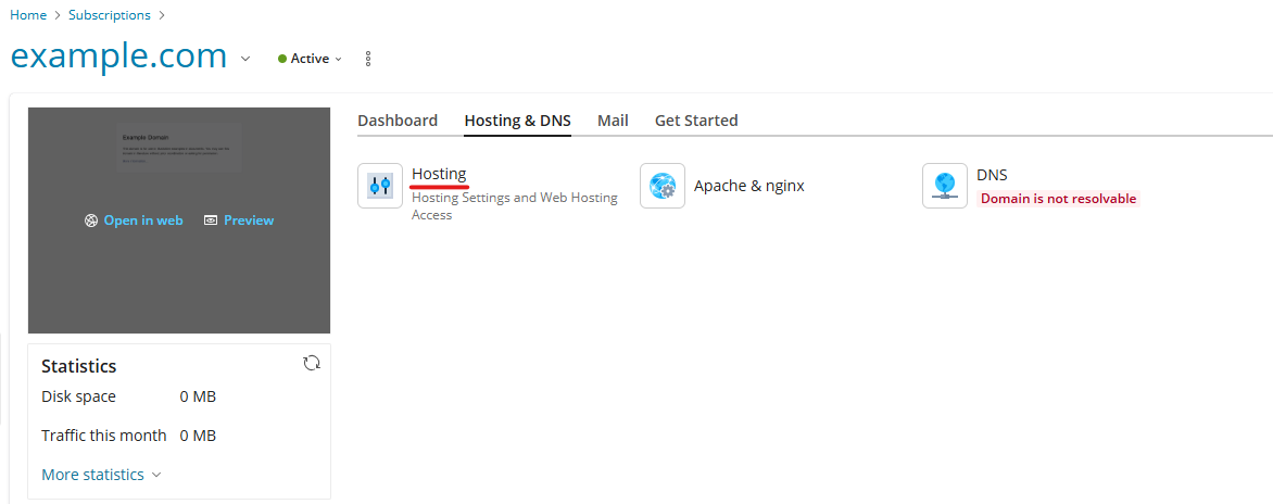

  1. Log into Plesk

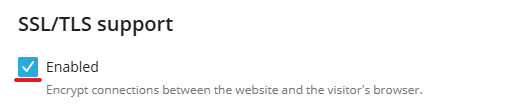

  2. Make sure that the website is accessible over HTTPS by covering the following requirements:

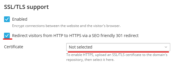

  3. Afterwards, go to Domains > example.com > Hosting & DNS > Hosting
  4. Enable the setting Redirect visitors from HTTP to HTTPS via a SEO friendly 301 redirect and select your certificate from the drop-down menu and press Save
    Note: If the setting Redirect visitors from HTTP to HTTPS via a SEO friendly 301 redirect is grayed out for you, please contact your service provider for assistance with permanent HTTPS redirection.
After this has been done, redirection from HTTP to HTTPS will be happening automatically for your website.

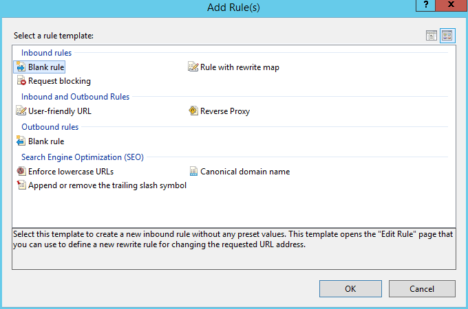

  4. Click Add rule(s)... on the right pane > under the Inbound rules select Blank rule and click OK:

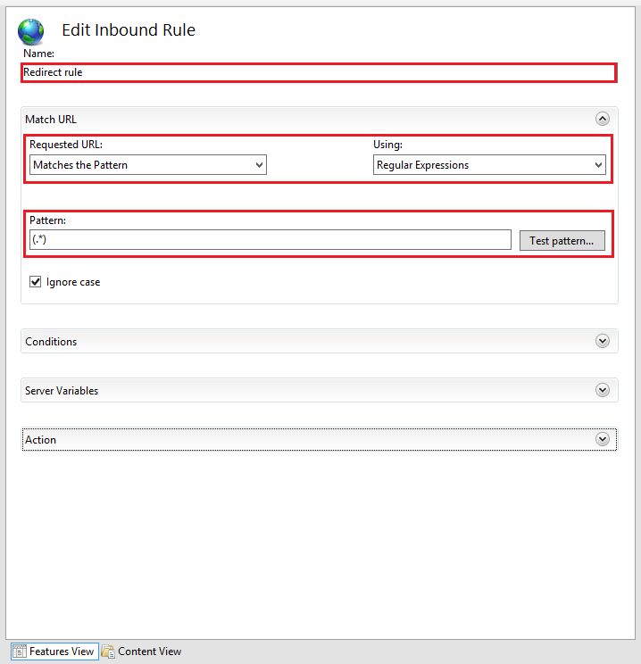

  5. Configure the new rule:
    • Set the rule name in the field Name.
    • Match URL section
      • Requested URL: Matches the Pattern
      • Using: Regular Expressions
      • Pattern: (.*)

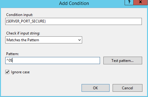

      Expand the Conditions section > click Add... and fill in the fields:
      • Condition input: {SERVER_PORT_SECURE}
      • Check if input string: Matches the Pattern
      • Pattern: ^0$

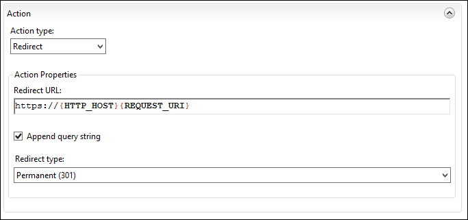

    • Action section:
      • Action type: Redirect
      • Redirect URL: https://{HTTP_HOST}{REQUEST_URI}
      • Redirect type: Permanent (301)
    • Click Apply on the right pane to save the rule.
