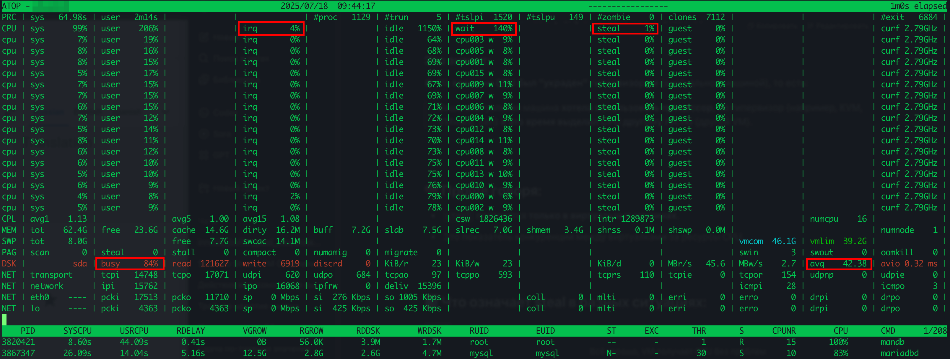

  4. Example and how to analyze:
    Main blocks:
    Block What it shows
    PRC (Processes) Total CPU time, number of processes, zombies
    CPU CPU load: sys, user, idle, irq, wait
    MEM RAM usage
    SWP Swap usage
    DSK Disk load (busy, read, write, latency)
    NET TCP/UDP network traffic and IP packets
    PID Process table with details for each
    How to analyze:
    CPU load:
    Metric name What it shows
    idle if <20%, then the CPU is loaded.
    sys system load (kernel, drivers). If sys >30% - system functions (network operations, I/O) are frequently called.
    usr If usr >80% a lot of calculations.
    irq interrupts (if many - problem with devices)
    wait >20% — CPU is idle waiting for disk or network. (usually slow disk).
    MEM (Memory):
    free free (unused) RAM.
    cache data cached by the system (e.g. files from disk), is good used for speed.
    slab the kernel allocates for data structures.
    SWP (Swap):
    tot Total size of swap partition/file
    used How much swap is currently in use
    free Free space in swap
    DSK (Disk):
    busy 70% - the disk is actively used.
    avio (average IO time): >10ms slowdown!
    avq disk queue, high value means disk overload.
    NET (Network):
    tcp/udp active connections.
    ip in/out useful for traffic estimation.
    PID table (bottom):
    MEM the amount of memory occupied.
    SYSCPU and USRCPU are the CPU load of this process.
    VGROW / RGROW virtual/real memory growth since the last update (tracks leaks).
    Analysis result:
    • DSK (Busy and AVQ) - A high value of disk queue (AVQ) means that the disk subsystem cannot cope with disk I/O.
    • irq 4% - issue with devices (Disk).
    • wait 140% - CPU is waiting for IO (usually slow disk).
    • sys 99% - System functions (network operations, I/O) are often called. Usually when the disk or network interface cannot handle the load.
    • steal >5% - indicates the use of virtualization, your virtual machine wanted to use the CPU, but the hypervisor (e.g. KVM, VMware, Xen) allocated the CPU to another guest (another VM) at that time.
    Summary: In this example, the server uses virtualization and has an issue with disk speed. (This may be caused by virtualization host limit settings or competition for resources between virtual machines.)
