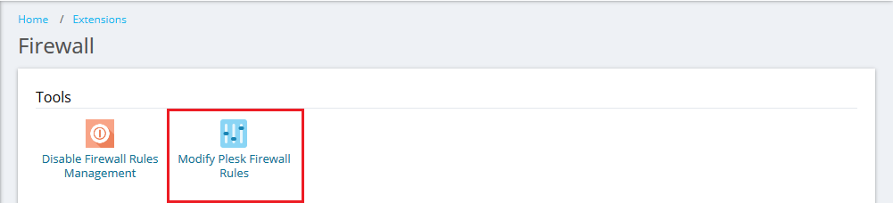

In Plesk, go to Tools & Settings > Firewall > enable Firewall protection > click Apply. All predefined by Plesk rules that are required for Plesk functionality will be enabled.
Note: If a custom SSH port is used, after enabling Plesk Firewall it is required to add a rule for this custom SSH port to allow SSH connections. See the instructions below.
To add a new firewall rule, click on the + button.
Below is an example of adding a rule that will allow connections to custom SSH port 2222.
Click Add a firewall rule button.
Fill in the fields and click Save:
