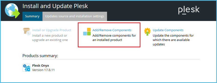

  1. Log in to Plesk.
  2. Go to Tools & Settings and click Updates and Upgrades.
  3. On the Updates and Upgrades page, click Add/Remove Components.

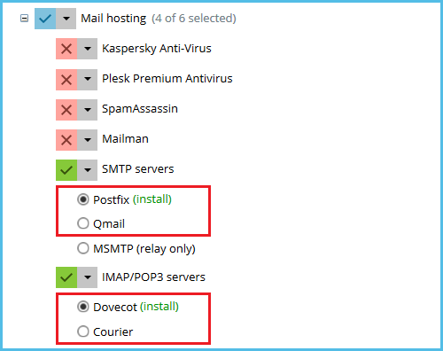

  4. On the Add/Remove Components page, expand Mail Hosting and select required mail components:
    • SMTP servers
      - Postfix (default)
      - Qmail
    • IMAP/POP3 servers
      - Dovecot (default)
      - Courier
  5. Click Continue to begin the installation.

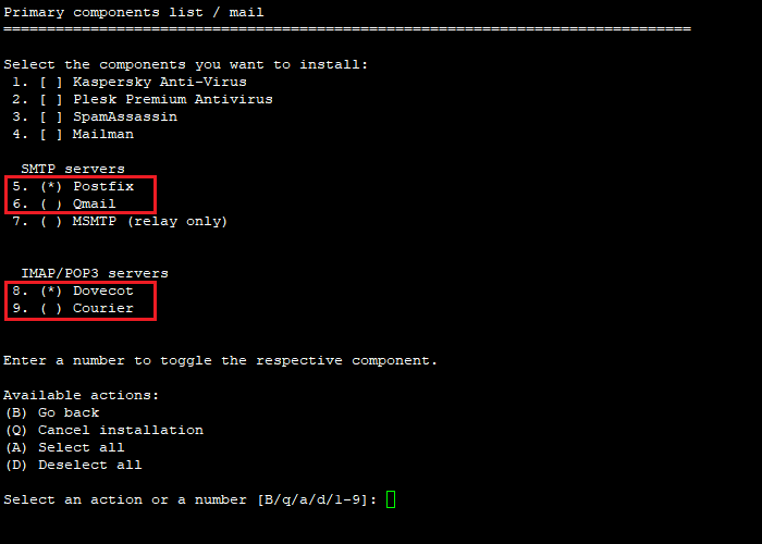

Interactive mode
  1. Start Plesk Installer:
    # plesk installer
  2. Proceed to the "Main components list for Plesk" menu.
  3. In the "Main components list for Plesk" menu, expand "Mail hosting".
  4. In the "Primary components list/mail" menu, select required mail components using their numbers:
    • SMTP servers
      - Postfix (default)
      - Qmail
    • IMAP/POP3 servers
      - Dovecot (default)
      - Courier
  5. Go back to the "Main components list for Plesk" menu.
  6. Begin the installation.
